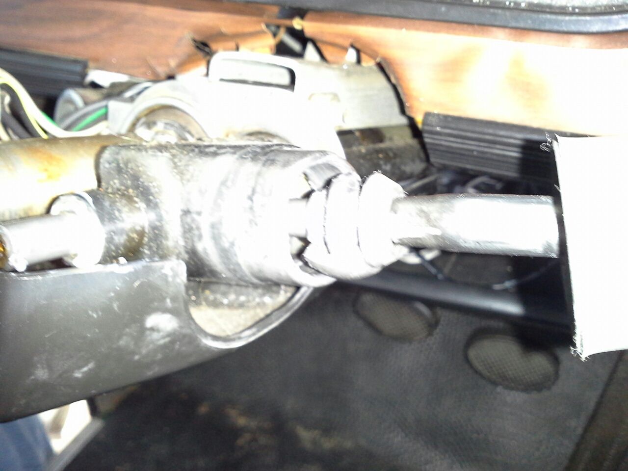

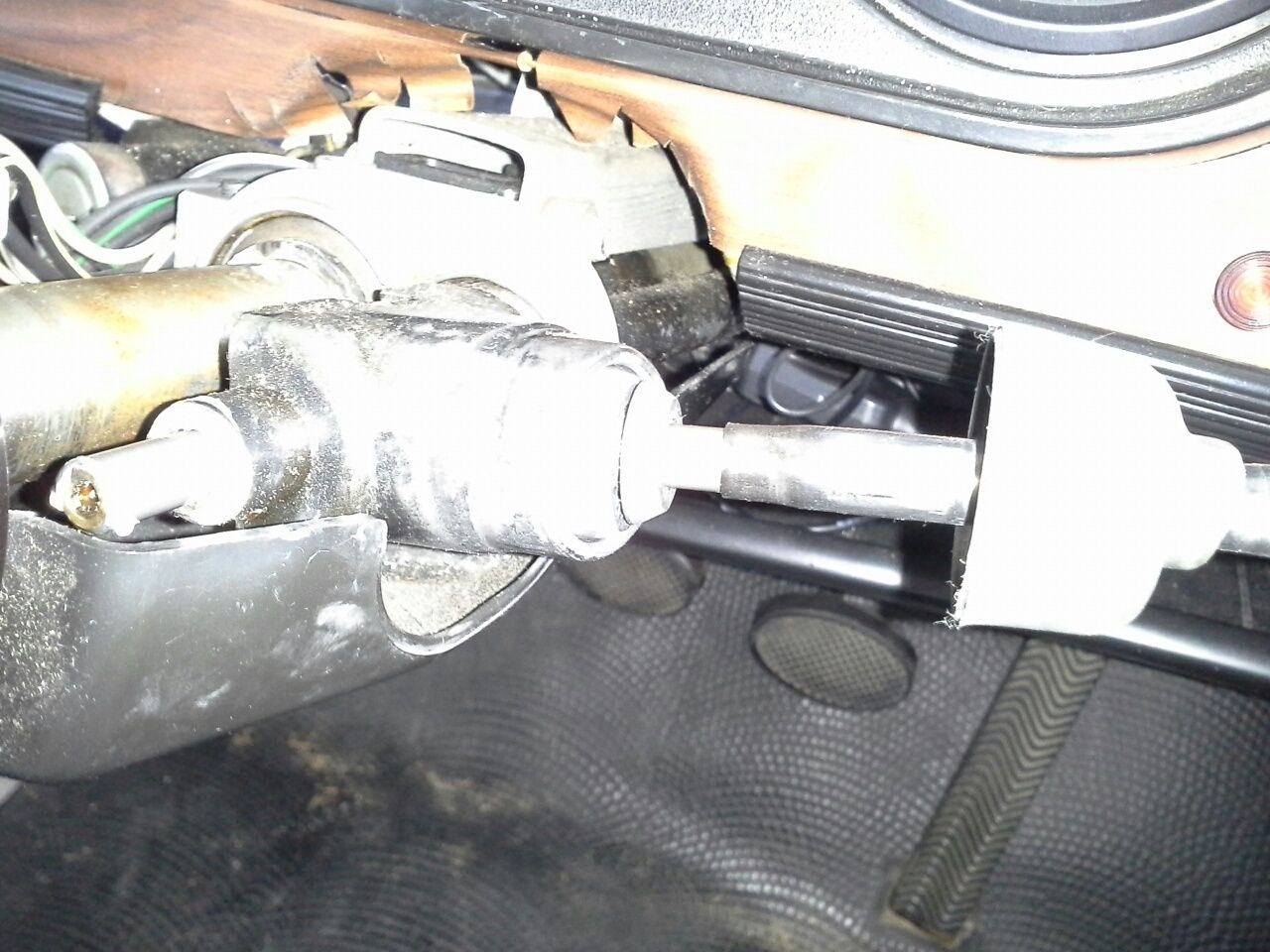

Here is how it is supposed to look under the cover:
And this is how it looks now (the end of the Gabelhebel with the ball on it has broken off and floats free out of the column):
Stig did you figure out any temporary repair or did you just replace the Gabelhebel?
Warre 1000
Frostsicherer Wartbürger
Beiträge: 2316
Registriert: Samstag 2. August 2008, 20:23
Mein(e) Fahrzeug(e): Wartburg 353 Limosine Bj. 1968
Wohnort: Finnland
Re: Need help with column shifter problem 353
Ungelesener Beitragvon Warre 1000 » Donnerstag 12. November 2015, 21:53
No, I do not have any tempory fix, but Wabufan have one. It is to fasten a handle on to the round bar under the dashboard. Not comfortable to use but working. Look at the fifth picture in Wabufans link.
It might be some help to put a hose clamper preventing the broken part to come out. But putting in reverse gear you have to keep it in place by left hand and trying changing gear with the right hand.

Ungelesener Beitragvon Jeff353W » Dienstag 15. Dezember 2015, 02:51
Sorry es so lang dauerte bis ich soweit gekommen bin: ich habe die Schaltung zerlegt und das Problem bestaetigt.
Habe Neuteil von Danzer am Schalthebel installiert. Muss jetzt wieder im Auto einbauen nur.
